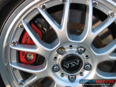

These are the ones Im using on my shogun project.
ASA AR1 16x7 ( FRONT )with REAL SHO 5 x 108 bolt pattern, tires are 205 50 16 , This is the proper set up for a fwd SHO. The Festiva uses SHO spindles front and rear, I would love to see them on a real SHO

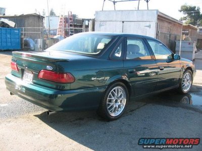

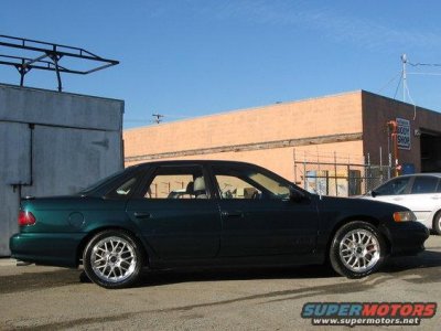

Lets see what this looks like
1995 MTX
235/45/zr17
Goodyear F1 GSD3
rim size: 17x7
Offset: +40mm
Bolt Pattern: 5-108
**weight: 20.7lbs.**
16" slicers are 20lb
Tire Rack
$130(each)
158 5831
158 5842
158 5836
