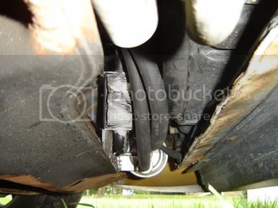

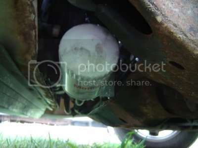

Black '93 said:
Wow! that's nice... I hope it wont have any affect on oil pressure though. Where are you relocating to? closer to the radiator?
I recieved the relocation kit without finding a place to put it first, and for a while I was worried that I would need to ship it back, I just could not find anywhere to put it. I was originally geared to have it so it was pointing straight down. I found that it would be nearly impossible. I also learned that there is really no place to put it on a stock SHO... other than here...
RelocatedOilFilter0003
RelocatedOilFilter0002
It has been SO hot here that I havent had the motivation to take any pictures of it until now, and I would only bear the heat to take what I could with the car on the ground.
It is mounted to what I believe is the cruise control bracket and that is attached to the subframe. PM if you want details.
