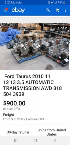

I just put a new old stock trans in my 11 sho. Theres a salvage yard in LA that has transmissions with about 100 miles on them that were removed from a large lot of cars. This guy buys 100 or so powertrains from Ford or dealers at a time.They come with torque converter. I did the valve body seperator plate update on my old unit and then the TC started slipping at 145k. I also put in a new ptu while I was in there and 2 new turbos. Village Ford parts in MI sells ptu for $520 and turbos for $420 with a $250 core charge. The trans didnt require any programming by the way.

I think freight from CA to CT might make that a little more expensive than its worth but thanks for the info I will go look at it and see what the quote is. Truthfully I kind of want the wheels and a few other things off the 13 SHO too but if that turns out to be too expensive(auction) I might go this route. I would also a lower mileage engine out of the deal too.
I paid 750 for the trans with free shipping. I sent them a check direct instead of doing the deal on ebay.
