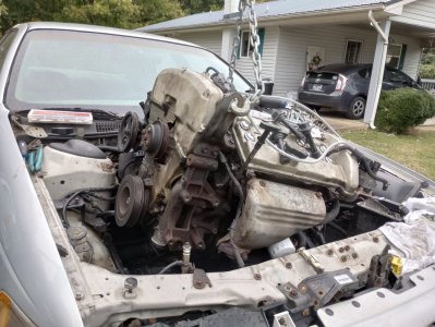

Hey, no idea if you're still wondering if it's possible to pull an engine through the top without removing the trans and I can say that it absolutely is. It's certainly very difficult but very doable, especially when you have no other options.
IMG 20220930 175044775 HDRIMG 20220930 175050272 HDRIMG 20220930 175917076 HDR
