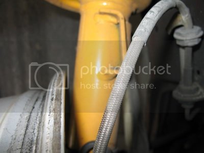

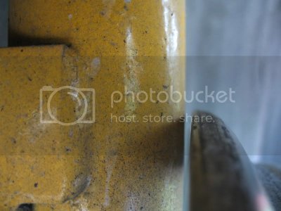

K-Dawg said:
The problem is that the 42mm offset may place the tire in contact with the strut.
It is kind of a big offset I know, but did you ever test fit them?
I remember Fred fitting them on an ATX with no problems with the rear. And the fronts fit his 90 with no mod.

I took these pictures. The front looks like it would probably be ok, but the rear is only like a millimeter or two off the strut tube.
Front:
IMG 0999
Rear:
IMG 1013

woa momma way too close.
A 3/8-1/4" spacer, and possibly some longer studs woulda been ok Im guessing.
