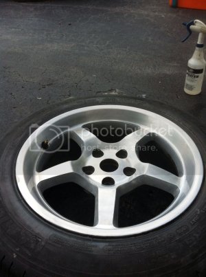

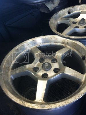

I attempted to refinish 1 of the ROH wheels today. They were used as winter wheels up north and are TOAST. Attempted just a plain restore today and Im not happy with it at all. I stripped the coating off the wheels with a spray on stripper. Then sanded the corrosion down with 320grit, bumped it up to a 400grit and ended with a 1500grit then I cleared over that. Well since I dont have time to polish these I am thinking of painting them so let the color combo suggesting begin. I have been thinking of a dark bronze. I dont want black like everyone else. Any way here are some pics.
BEFORE:

AFTER:
B55D 762BCB6E9781 102 00000005176C6FB8 zpsd6ad658a

I think they look good as is. Run them like that for a while and see if it grows on you.
9,045
4,390
Pretty nice job, Zach! As long as they are balanced and trued, I second the motion to run with 'em as is ...
