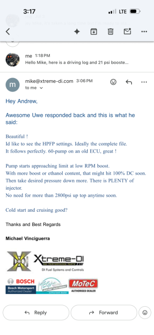

Uwe responded. IMG 0898
I see this up myself. Coming in at 2200psi at 4500 rpm peak torque and ramped to 2800psi for 6500 rpm.
I’ll be getting a log tomorrow.
