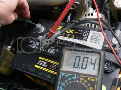

Ok.. well here it is... You can see, 770CCA @0 Deg.. 900 @ 32... manufactured 11/07 Johnson Controls.. here in Fort Wayne I believe.. same place who makes die hards and az advance whatever...
This first one was a test... and is the reading I got with the trunk open... (1 194 bulb)
P1040609
This is when I closed the trunk..
P1040610
So... .48 - .04 = .44amps x 12volts = 5.28 watts... sound right for a 194 bulb? sounds ok to me.. I'm not sure.. so there is your "is your meter ok" question. And still.. .04 amps.. shouldn't be killing this thing.

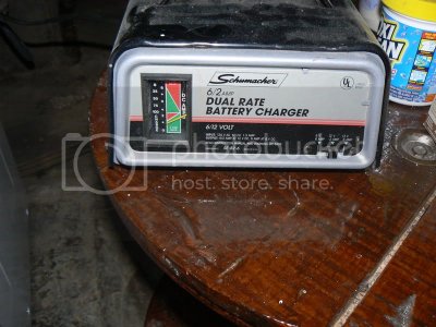

And it measured like 10 volts when I pulled it completely. I put it on the charger..a nd this is what I get...
P1040611
Sounds / looks like a bad plate / cell in the battery maybe? Arent there 6 of them? 2v a peice more or less right?
