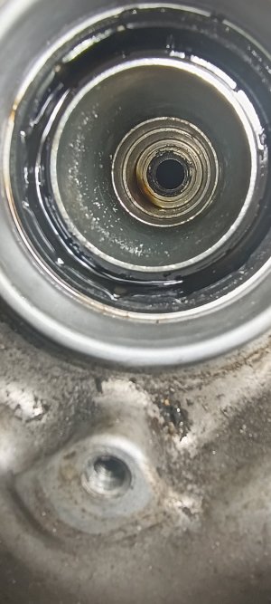

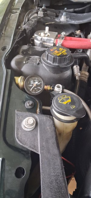

After a blast of seafoam through the intake and a thick cloud of smoke I drained the oil, scoped the pan, changed out the old oil sender for a braided line to run up to the new gauge,

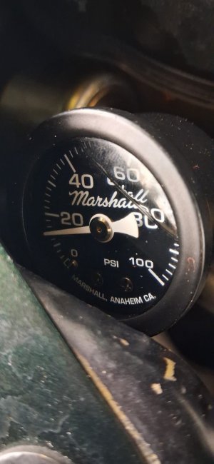

All said and done after an hour of running, 45 min idling, 15 minute spirited drive, I landed at 15 psi
20251229 153244
its a slight improvement so I'll take it and just see how long she goes for. It idles better and seems to have a bit more response.

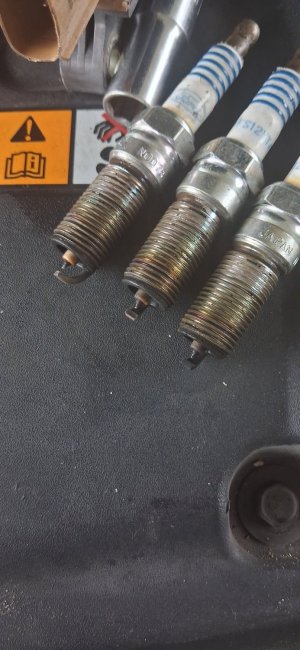

Started on the new spark plugs and coils earlier. The rear 3 were mostly slightly annoying. I had to break the ones on the front free with a bar but fine after. That middle front though, I had to soak about a half inch of oil out of it, then had to use a breaker the entire way out. It looks a previous owner screwed up the threads on the plug before they put it in the car. Used the endoscope and saw it looked like it still had threads toward the bottom, called my friend and we decided to just send it, he can take care of it when the motor's out for the torque converter. Looks like I'll be doing the front valve cover gaskets and plug tubes tomorrow when i can get the parts and a damn T45 for the hpfp...
