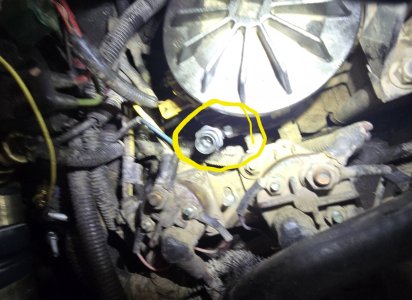

This weekend I changed the oil in Betty. I also got around to finally installing the fuel pressure sensor. I had to remove the lower plug which I have circled in yellow. This is the fuel pressure that is going to the injectors. Also sorry that it looks like I took the pictures with a potato.

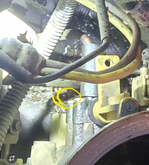

I had to add a 90 degree adaptor fitting.
