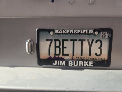

Also Betty's new plate came in. The truck was purchased at Jim Burke Ford in Bakersfield 25 years ago, so I think it is fitting that it stays on the truck.

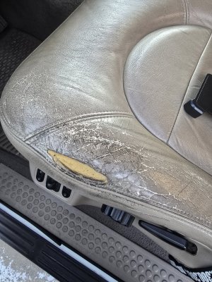

Ford F450 Update: Pulled the seat covers and this what the driver side seat presented.
20250813 063846
20250813 063854
Yes they are dirty, but they can be cleaned and re-conditioned which I will do. The rest of the seats are in great condition. No tears, no cracks ect. Still undecided what I want to do with the driver's seat.

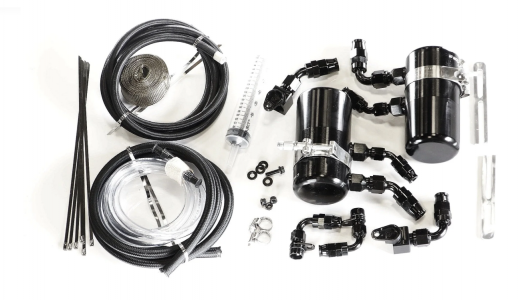

E63S Update: So the model years of 2018 and 2019 of the E63s and AMG GT's had Oil Vapor Separator (OVS) issues. The OVS are basically like a mechanical catch can that then reintroduces the oil vapor back into the intake track. Well these get clogged and when they do, crack case pressure builds and it pushes the rear main seal out. This is was big reason why I wanted to buy a 2020 E63s because they had revised the OVS. However my 2019 was a deal and when I had the upper oil pan gasket fixed, they saw that my RMS was seeping, and they replaced it. They tested the OVS and they passed, but after 36k miles it clearly wasn't doing its job correctly. With the tune that I am running the stock turbos are running a sustained 26 psi, so crank case pressure has been on my mind.
So finally someone brought a catch can to market for the E63 and after a year of testing ect....this is what they produced.
Opera Snapshot 2025 08 13 115440 www63motorsportscom
They look amazing and people say they work amazing, but that price tag really hurt today. I have some plans for the E63 once it cools off, and I know these will be needed, so I might as well bite the bullet now.

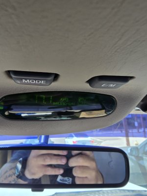

Ford F450 Update: So like an idiot, I removed the DTE calculator and had to resolder some joints...and I didn't take any pictures. FFS.
However, I did fix it. So it works now. I dont know when the display went out but I am pretty it went out years ago. So that being said when I plugged it in it said it was averaging 11.4 mpg. That makes sense with the old gears ect.
I reset it and this is what it averged down a a 30 mile clip down the freeway at 70 mph.

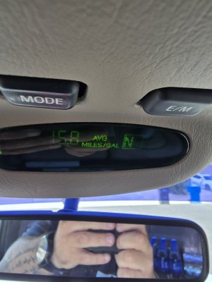

This was after 100 miles of mixed driving. 75 miles on the freeway traveling at 65 to 70 mph, and then 25 miles in the city.
20250815 132452
I am not going to reset it until I fill up again, but that should be give me a pretty good idea of a normal tank of driving. Of course I will to the real math as well and see how off the DTE Calculator is off.

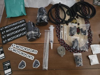

E63s Update: This is what $1632.23 buys you in the dual billet catch can world of the 63 series of AMG.
20250815 140159
The E63 has a appointment at Mercedes on Monday. It needs an oil change, spark plugs, and an OVS test.
Anyone care to take a gander of what that will cost?

At least you got stickers, very important, no kit is complete without them
