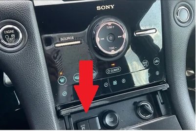

the plug for TCS/ESC is under the radio console forward of the shifter, the PPs have a TCS button inside that little cubby that you have to push twice rapidly I believe, non PPs usually have parking assist, I'm told rare 13s had both, but if there is a plug for the TSC button it would be under that panel
Tscesc
this one has the parking assist, on PP they have a TCS button instead, if your car is wired for it, the pinout on the plug going to this switch will have more wires than pins in the switch since they share the same housing. If the wires are there you could in theory wire in a momentary switch to the 2 wires not being used. I have an early production '13 non PP and the wiring wasn't there but you might get lucky. I believe the ECM cuts power to the throttle if it senses the e-brake or regular brake engaged while giving it throttle. as for pulling the fuse and letting her eat, your dash will be lit like a Christmas tree but I cant think of a reason it wouldn't work unless the ECM cuts throttle when it senses a slide, with how involved the ESC system is it wouldn't surprise me if its integrated into several systems.
I've decided I'm gonna try to program the esc to turn off with Forscan, and if that doesn't work I'm probably just gonna call it quits on trying to get this car to slide. Thanks for the this info though.

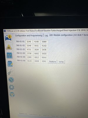

Is there any as built data for the 2010 pp Taurus the guy in the video has a 2013 and his configuration is different from mine. I attached a photo of mine.
I'm not sure, it's been a while since I've used forscan, and I have a 2018, so I wouldn't be much help anyway.
Sent from my SM-S918U using Tapatalk
I’ve been trying to find this information, and every post I find they just say they did but don’t provide any info on how. I can’t find any as built pp configurations on this year model online at all. Super frustrating.
