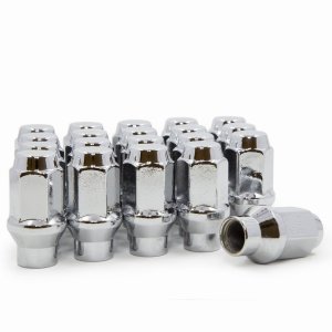

So Gorilla makes a ET style lug nut that extends an additional 0.25 in past the taper.
ET Lug Nuts
If I put a set of rear wheel studs on the front hubs, these lug nuts give me 49% thread contact at all wheels.
Still not ideal in some ways, but very ideal in others. I like the idea of no gap between the studs and the rims - as the 0.62" O.D. of the extension is theoretically exact to the holes in the wheel.
Wheel Hole Size
I'll keep searching for studs the length I want. Probably have to go custom if anyone does that sort of thing, but these lug nuts will be a good temporary compromise.

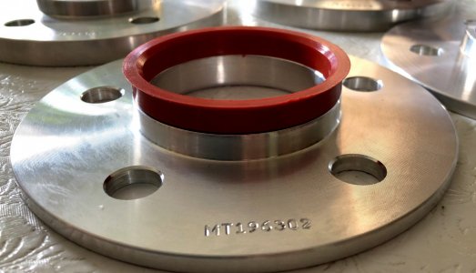

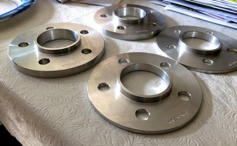

Just laid hands on my custom wheel spacers from motorsport technology. They're very professional and badass double hub-centric spacers, and since nobody I know (besides you guys) cares about how gratifying it is to find someone who takes pride in making custom **** for our rides, I figured a mission report was in order.
First of all, these babies are made out of 6061-T6 aluminum - same stuff they make satellites and jets out of.
I really lucked out with finding this shop; they are probably the only online custom shop that allows you to literally select your own dimensions for the hub-centric features. I hit my hubs with calipers, then added a thousandth and typed it in the website.
Admittedly I have not taken calipers to these yet, but they looks so good, I'm not ready to potentially ruin the moment yet.
The spacers in back are 7 mm thick, and the front ones are 6 mm. It's always annoyed me that the rear tires are so damn far back in there... I'd like them to at least be even with the fronts. We'll see if 7 mm was thick enough.
IMG 3087
So I got these spacers to make my new wheels work. To securely fasten down my new tires, I may need to make my wheel studs longer. Once I get these spacers on the car, I can decide if the studs need to be upgraded.
p.s. booyah. so far so good.
IMG 3088
