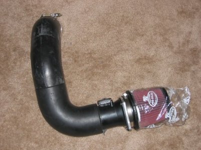

Here is a picture of my setup before adding a filter over twice as large as the one pictured. The MAF is no longer pre-SC. I used exhuast pipe and clamps to couple it all together.
