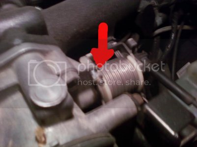

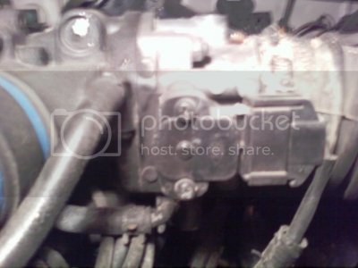

I did see this when I picked it up but I thought I broke it all out when I hit it and pulled a piece out. I think that when I hit the top of the cover I might have move the TPS (think thats what it is. On the front of the TB in this pic). I did move it over just a bit tonight to see if there was any help and it did idle a little smoother. Un hooked the MAF and it got worse so it isn't too dirty but I'm going to clean it anyways.

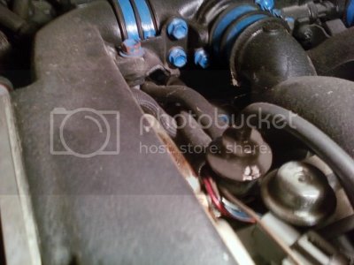

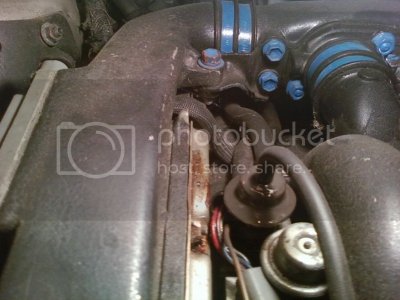

The FPR is leaking that glaze on it is fuel.

I did let it idle for 5-10 mins and it was pretty even, There was a little movement of 100 or so RPMs nothing major. But when I would give it gas after I let off it would bog down to 500 then up to 1100 or so. I took a video of the tach and under the hood to get some audio (well try to)
Is this the Throttle plate stop screw? It is really lose when I touched it so it might have been messed with

The stop screw certainly looks messed with. The nut on it is the locknut and is suppose to be tight against the TB. You'll need to go through the base idle setup procedure. I've attached it from the FSM is a MS Word document.

is the actual FPR leaking? seems odd 3 would... we hardly ever have problems with them..... its probably a gasket leaking......
See that is what I thought. Or he didnt install it right. But if you look at the pics (Not the greatest, taken at night) that glaze look is all fuel.

That was my first thought.. I'm thinking they didn't use a new copper washer. Granted I swapped a few around on Boat's car, and his didnt leak reusing the gasket / washer. But I can see how it *could.
I would also see if you can't get that stop screw (close) to where it should be on a stock car. Maybe using a tape measure to kind of eyeball it. That really does suck tho, if that moves, the computer / car will always be trying to 'fix' that.
