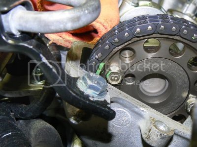

Ok.. well I know some of you have been reading my last posts.. and I'm no mechanic, but I've searched a lot, and am still clueless, and everything looks ok, to me anyway. Anyway, please let me know if anything looks wrong.

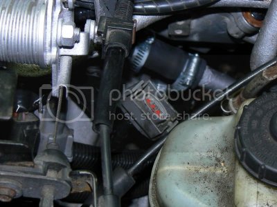

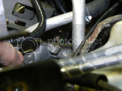

Here is the only connector I dont have a spot for..
Connector

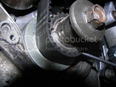

The allen wrench shows the position of the mark, 9 teeth off the line
Crank

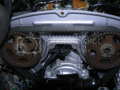

Top side, also 9 teeth off, so I should be ok?

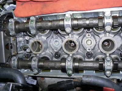

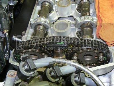

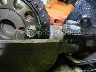

First two cams, from the front going back, #1, #2
Cam12
Cam 1
Cam1
Cam 2
Cam2

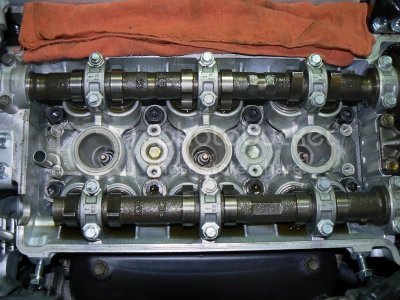

Rear two, #3, #4
Cam34
Cam 3
Cam3
Cam 4
Cam4

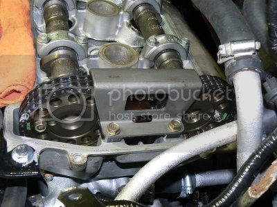

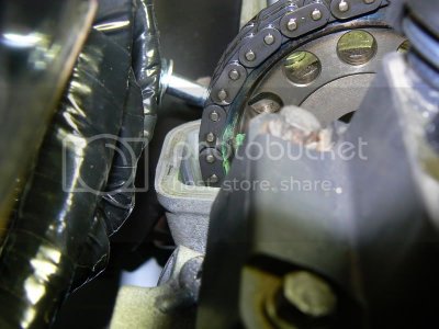

Front
Front 1
Rear
Rear 1
I have no reading on the fuel pressure rail, but I get a good bit when depressing the schrader valve, bolts on the fuel rail are all the way tight, the injectors will spin, but are all snug. All connectors seem ok. Someone pleaseeeeeeeeeeeeee tell me new motors are just testy about starting when new. I dont understand why it backfired.. at all.. I was giving it some gas when it happened, and maybe I just got her flooded. My codes are only 511, and 111. Rememeber i have a Ted B chip, so thats probally why I have the 511. How can I test the coil with a multimeter. I'm going to look at the plugs and see if there is anything funny in there.

yea it is.. thats why i had the allen wrench pointing to the mark. They are equally spaced, 9 teeth off. So nothing really 'slipped'

lol.. it was lined up perfectly when I first did it. It shouldnt make any difference as long as they are the same distance away I would think. Anyway.. I'm about finished and will get a video of it starting, or not...

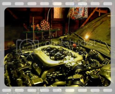

Well.. I guess it just wanted to be triple checked. Cause she fired right up. I'll get the video up in a second. My exhaust isn't mating up perfectly, so its a little loud. Also it seems to be smoking a little bit, and I wondered if thats pretty normal. Can't really pinpoint where its coming from but its there none the less. Maybe some of the old fluids that dripped on the exhaust maybe. Anyway.. one thing I did notice was something I can only explain as a vaccum - like sound. Havent ever heard it before maybe its normal. I'll get a clip.. seems to still be learning sensors.

Well, I started it twice, and the vaccum thing is still there, and I'm wondering if its a bad p/s pump, or the water pump, those are both stolen off the old car, were working when I took them off. Wondering if the bearings were old or something, but something sounds very wrong to me, so I shut it down. The only other odd thing that could be pressure related... the metal part of the hose that connects to the p/s pump got a little bent, maybe thats causing some funny stuff?
Let me know what your concensus is on this.. I'm not starting it again until someone has a clue what to check for. Thanks!

Just a thought... it almost sounds like when you try to whistle with a peice of grass... maybe this is something to do with air squeezing past the secondaries?
midnightauto
THE CHOP SHOP
Jan 31, 2006
150
25
Michigan
by listening to the video you get the noise as soon as it starts for a split second then it went away until the rpm's went back up and it came back louder. could you have a vacuum leak around the idle air motor or a defective one. I may be wrong but I think the idle air motor opens to maintain the idle and will close as you give it throttle. that's what it sounded like in the video. engine off idle air closed and whistled until it opened to maintain idle and started to whistle again as it closed when you gave it gas.

Well... I'll have to let her run a little while tommorow and try to see where its at. I did have the vac hose that runs from the TB to the IAB, well that peice next to it.. the one of those 2 that is closest to the radiator, was just chillin there.. had to tighten him back up. Maybe that was it. I wont know until the morning, because its 2am and with my exhaust not quite sealed.. I dont think they would appreciate me letting my car warm up, squeaks or not.
