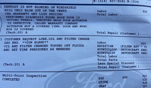

Update
Took to Ford. And once again you guys were correct. The motor isn’t working to move the door. No sweat, I have the ‘best extended warranty’ so I was told. It’s not the best, it doesn’t cover this issue. However approx $900 will get it fixed. Not sure if I’ll fix it or bring back to Ford.

ford premiumcare is best warranty you can get, idk what you have.
if the problem exists only on the drivers side or only on the passengers side, then yes, it can be that side's blend door actuator.
if the problem is on both sides, you have the unfortunate possibility of a mode door actuator being involved, which is more of a pain to fix, as per video above.
what dtcs have you pulled up? you need an obd scanner that reads both the ms-can and hs-can buses to get a complete picture. there might be battery voltage involvement.
do you have the work sheet from the dealer showing the results of their diagnostic? plz post if so.

I do have the papers & will post them later. As for my warranty, it wasn't the Ford Premium Care but I'll post the name with the papers.
Problem is on both sides. And we have a scanner, I'll try that too.

Attached is a pic shot of the paper work about the defrost.

Update: It's been a week of phone calls & asking question with dealership & CNA National. Then the dealership General Manager called stating the system was showing the wrong warranty to my vehicle. Glad I kept pushing.
It does bother me that vehicles & warranties have gotten so complicated that a less than $100 part can cost up to $900 to have fixed. Now Im on a new journey to find a 2018 or 2019 SHO.
