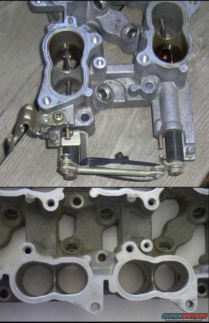

Which one of these do you think can pass more air?Lim before and after gutting  irm tieback
The shafts take up over 3sq" of area.

They restrict the airflow to the smaller intake valve port under 3400 rpm. But there is no secondary runner. Below 3400 rpm the engine is detuned so that when the secondaries do open you get a nice kick,
