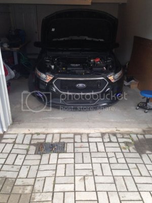

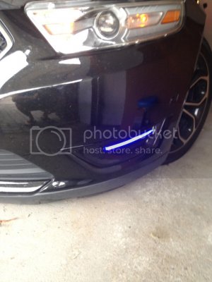

So Today, I removed the front bumper to have a look at it. Both connectors had corrosion in them so I cleaned them with an electrical connector cleaner, let everything dry, plugged everything and now... the LEDs are blue! The passenger side one halfway between white and blue while the other one is as blue as it can get.
LED2 zpsenw5xj6m
LED1 zpsc1rdkebx

One thing that maybe happened is the corroded connection is limiting the circuit from flowing enough current and, at reduced current, the color temperature of the LEDs is higher. I can't say I've ever experienced that phenomena with white LEDs, but in addition to having a blue hue, it also seems to have reduced intensity.
The only other thing I can think of is that the LEDs in the strip are actually RGB LEDs and for some reason the connection for the red and green elements is intermittent.
