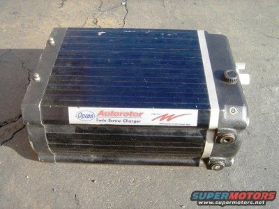

I have a whipplecharger from a C32 AMG. I kept it thinking I might have a use for it in my SHO.
Dsc01295
