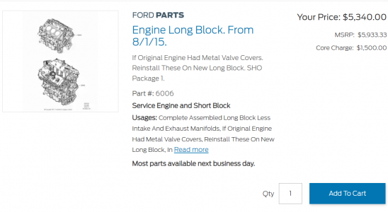

2016 with 85k on the clock. Both turbos puked and burned all of the oil out of the engine. Ford tech put in almost 6 quarts and it burned that while he was working on it to diagnose the stumble/miss off of idle/no power/excessive smoke. No compression on number 2. Estimate to replace engine and both turbos...almost 25k. The dealership is going to warranty the engine, I pay for the turbos and related plumbing. This is my second SHO the last one a 2012 purchased new and traded in with 125k on it. Only repair was the PTU, normal stuff. I am fortunate my dealer is willing to work with me. You bet there are variations in production!
13,278
5,158
$25k for just an engine replacement? I expected a good amount but that is alot
