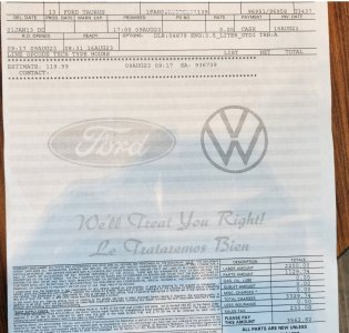

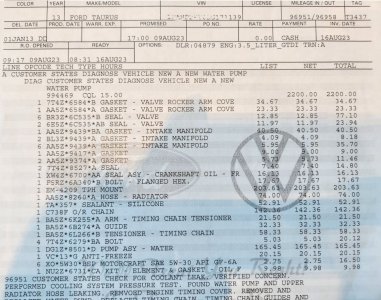

Mine was done right before I bought it, they did it because the water pump gave up so that was replaced too but the one thing I wish they had done was the oil pump, its a couple extra steps after the water pump comes out but its deep so while youre in there some preventative maintenance couldnt hurt. the pumps arent too expensive and I'd imagine the extra labor wouldnt be too steep, worth asking about. from the Ford/VW dealer that did the work to my car the invoice had a total of $3562 parts and labor so i'd guess a smaller shop would be cheaper, heres the service ticket from my car
