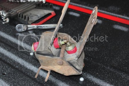

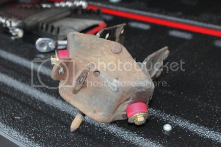

I used whatever size bolts fit Energy Suspension PN 9.8105R. The package says the ID on the bushings is 3/8"
I didn't notice any additional NVH on this stock mount. I'm about to do the rear mount to match, although it hasn't failed yet.
MotorMount002 zps12ca9c1a
MotorMount001 zps89859cbd

Whoa! Very interesting.....
I never liked the idea of securing the two halves together with bolts, however, using those sway bar links changes things up a little. Did you come up with that? I never saw that idea until now. I have actually given a LOT of thought towards the design/function of both engine mounts but totally gave up on the 'bolting' method a long time ago.

Kelvin, that's well done. The bushings would go far is lowering any NVH on acceleration.
That's a great idea! I have 4 of those bushings and washers in the garage. Main thing i need to know is how long the bolts need to be.
