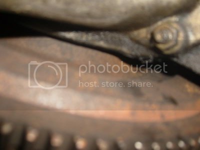

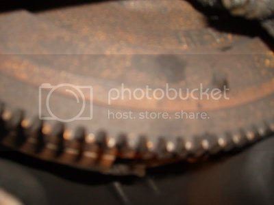

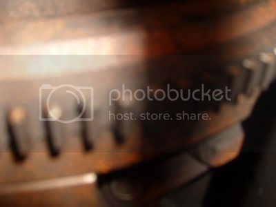

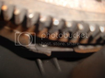

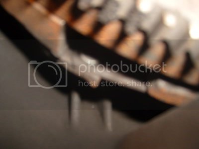

ok here are some pics. sorry some are blurry. I really hope its the 9.25. It will be alot cheaper for me.

Every thing in this car was original, I just did the first 60k. It still has a recall from 92 that still has not been done. I couldn't find a recall about the clutch.

The 90 in my driveway made it to 140,000+ miles before I took the still-functioning 9.25" clutch and replaced it along with the engine.
By the way, in your picture it's hard to tell but it looks like the 9.75" pressure plate.

The pictures indicate you have the 9.75" clutch. I am 100% positive.

It is a 9.75 and that is a good thing. The day is coming where the little guy won't be available at all.
