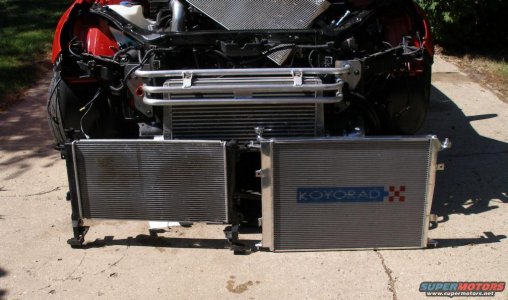

I have an all aluminum welded radiator on my Genesis too....
Radiators side by side 2
