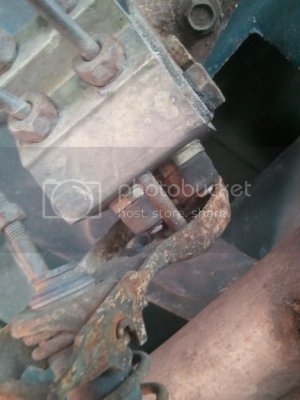

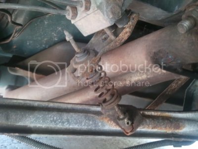

I was under the car today and noticed this. What exactly is it and what does it do? It appears to be broken.

It just kind of moves around and squeaks a lot if I grab onto it. I appreciate the help guys.

And to expand a little on what Donovan said...The heavier the rear of the car get loaded down with crap, the more this little valve lets the rear brakes work. The lighter the rear end, the less pressure it sends to the rear brakes.

I had one for a while that was rigged for full power braking to the rear and it made things interesting.

do a search, there are plenty of threads i remember lurking through about the bias plugs and their function. I used some safety wire and tied mine off to see what it would do with full power braking in the rear (as if I had a full load of weight in the trunk and the back seat) and it made the car prone to breaking loose a bit in the back under hard braking.
of course i also had my ABS disabled too.

Well I use the car as a DD in the spring, summer and early fall. I have my two sons in it quite a bit so I wouldn't want to do anything to make the car unsafe or unstable. How exactly did you tie it off? I'd like to experiment with it for a little while when it's only me in the car.

My question was not because I was looking to upgrade. My brakes work fine as they are. The question was because I noticed the spring assembly looked like it might be broken and was more or less looking for preventative measures to ensure there were no issues with the brakes while I had my boys in the car. Thanks for all the info though!
