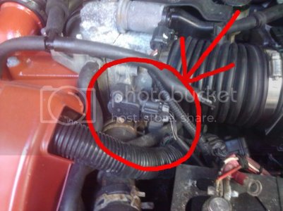

What Is this.....
SHObill
'The Collector'
Feb 26, 2002
1,410
379
Rochester MI-48307Detroit
Thats your TPS = Throttle Position Sensor
If you unplug while idle, may stumble or stall.
Idle will be erratic when you apply gas.

The same happens for me, but it shouldn't stall.
It should stall if you unplug the IAC... the computer doesn't rely on the TPS readings as it does the IAC readings for operation, so when you unplug it or it starts malfunctioning, I think it reverts to some sort of default.

For reference, the IAC (Idle Air Control) is the connector directly above the TPS in your picture.
