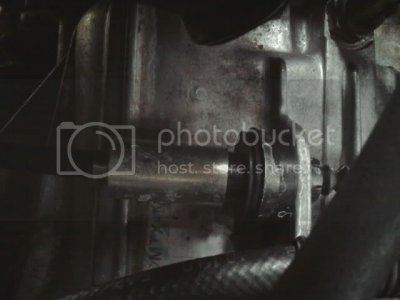

Glazed clutch and/or clutch cable bushing? Mine did the exact same thing especially in reverse because that bushing was missing. Cost me an axle from jumping so bad.

The bushing provides tension on the cable by bracing itself and the cable housing against the bracket on top of the transmission. Without it you not only lose full tension, the cable cannot be adjusted properly causing all kinds of problems especially in reverse where the gearing is for torque. The pressure plate never fully releases the disc off the flywheel and only gets worse with more throttle causing the whole car to shake violently. Get a bushing on there ASAP or you'll end up breaking things. And Ford still carries them.

The bushing isn't white. It's black and on top of the transmission housing. It has an plastic outer housing on it that should also be black. How old is the cable? Have you ever looked at the clutch quadrant itself for missing teeth?
The stock bushing is a two piece bushing that is white with a rubber insert. The rubber piece can deteriorate over time. ShoSource created their own bushing that is one piece and are SOLID. Their bushings are black.
Factory Ford bushing.
