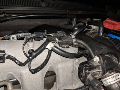

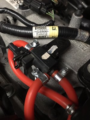

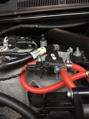

Since getting it back from the stealership for extensive repairs, the plastic engine cover no longer securely sits on the three pegs. Upon further investigation, it seems the culprit in these small vacuum hoses and the small sensor they plug into that is mounted at the top of the intake manifold. I cannot for the life of me understand why one would be directed upwards. I am hoping for some point of reference to know what it should look like so I can fix this and secure the engine cover properly. See attached pics. Thanks in advance.A9ba40f3d351ef31b022cfb82462036b29ffce6103a040998b6ed12f35b5ae5f2c04e8077ab0c8e82971f805f1a96d53083a7f62878e8eaad6e1dc44d0f16976

That sensor is oriented 90° up to far.
And it looks like it’s mounted to high on the intake.

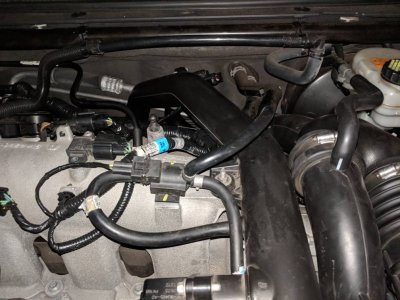

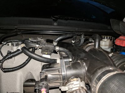

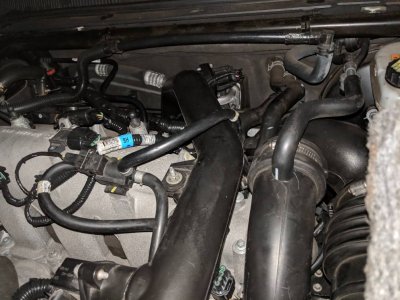

I’ll snap a pic in a few min
glockcoma
Jul 25, 2016
339
418
Yep. It appears the mount clip is missing from yours and they rigged it up. 8922424735696c5b47b9a1453c92e8386b497139c76806ff3c8061e97a9449b6

Damn... Alright. That's what I figured. These guys did a real effing hack job putting this thing back together. They broke one of the female posts on the cover itself, probably trying to force the cover down. Alright, now that I know what it's supposed to look like, I will see what I can do. Appreciate the help.

Finally had some time to get under the hood and work on this. Was able to reposition the sensor so that it lays flat now and the cover went back on properly.
