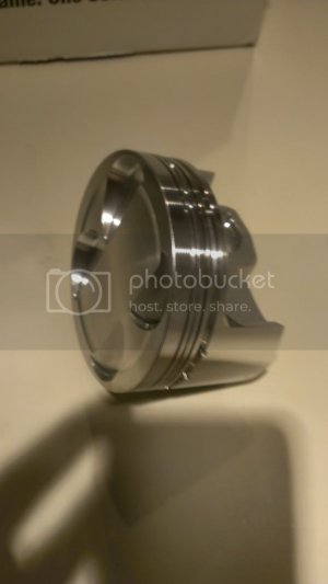

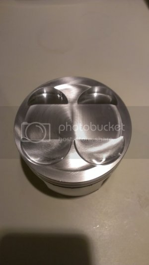

Yay pistons.

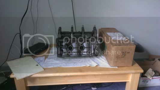

Inspected, clean and flux'd block. Changed machine shops so its sitting in my living room for a cpl weeks. Dropping everything off soon. Hopefully I get it back b4 Halloween
