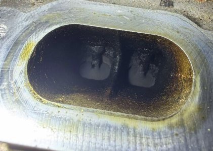

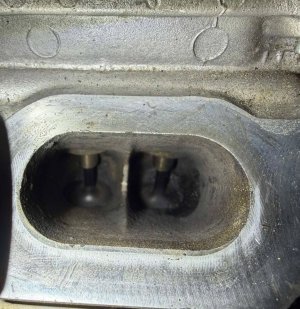

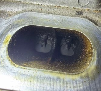

Have a 2018 sho hit 100k miles this year. Took me forever to find someone who would walnut blast the valves for me all the Bmw shops turned me down. Bought a valave cleaner off Amazon. A shop called baker but garage off alta drive did it for me. Great guys they work on alot of imports but they did a **** of a job. Even had my wife's 19 explorer sport done last week. If you need this service in north florida hit them up.1000020169

Yeah paid about 250 for that service at 69k miles it does hardly anything for carbon deposits. The walnut blasting as you can see made the engine like new restored throttle response and my car runs smother an the rpms are lower at say 70 / 80 mph.
