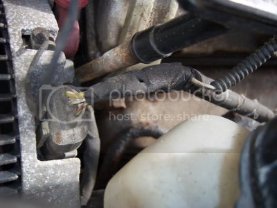

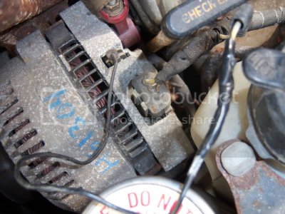

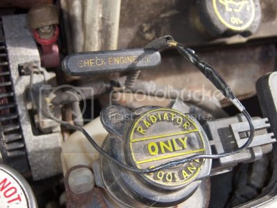

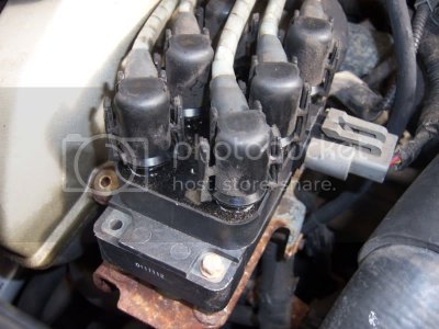

The coilpack looks new already.. 100 0529
I'm not sure exactly which wire to test and is a multimeter alright to test it with?
100 0530
100 0531
100 0532
Storm-Chaser
Jan 26, 2005
2,786
258
Shit Louis
Anything above 14.5v suggests a fault/failure in the voltage regulator. Take the alternator off and have it tested at Advance Auto or O'Reilly's. Also, check the voltage output at the battery, as well as verify that the alternator is putting out 130A under a load.
