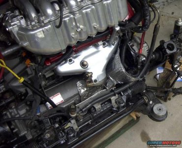

I thought the alternator goes out so frequently on the V8 is because of it's closeness to the exhaust manifold. I had a piece of the jiffy pop type insulation curved around the back of it to protect from the radiant heat. Used some wire ties to secure it in place.
Alternator heat shield 2

The alternator will slowly put out less voltage as it ages. The oil on the back has nothing to do with it.
That pic is a motor with a new block ready to go in.
