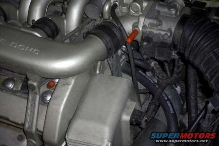

To reduce the oil in the intake and carbon on the runners, plug the larger line going to the valve cover. This also give a small HP and fuel milage increase while reduceing the oil in the plug well problem along with other oil seal leaks.
Etfilephpid53339togglefullsizefV6 PCV plugs
SHOZ123
Dec 2, 2000
12,152
673
Illinois
Those are just a plastic plug. Actually came off an older fuel filter where they were used as protective plugs. Any 3/8" vacuum plug will work.
I know this is an old thread, but it's an important issue.
You should not plug the line in the valve cover. Doing this can cause a pressure buildup in the crankcase and serious damage to rings and loss of oil. Instead, vent that line to the air using one of those cheap filters used in 1970's cars.
Agreed, you need to keep a vacuum on the engine. If not the oil loss will be from the seals and gaskets because of the increase in pressure.
