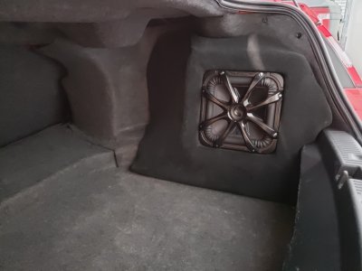

I added a sub to my car by taking into a pair of factory speaker wires with a converter, hid my amp behind the factory padding, and made a custom fiberglass box, mounted in the right pocket of the trunk. It was a lot of work but similar results can be obtained for much less.

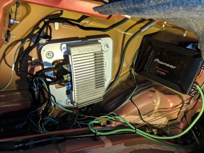

Here's the factory amp (if you have it). You can pull a high frequency from there and convert it for an amp with something like a Pac LP7. That was the original amp I used, I ended up swapping it for a newer model.
I don't have a pic of the factory subs, but the **** in the left of the 2nd picture is the magnet for them. That's honestly the easiest/best place to pull signal for an amp because you don't have to trace wires from the amp and those subs should be getting more power than most speakers.
Pulling power for an amp is a PITA since there aren't many unoccupied holes in the firewall. I ended up removing the plastic cover under the wipers and fishing it through there. Ef83eaf5c7e8ae668ea39db6978acb2a0dde98138b14d10f1f8a2f0f7a5f2279

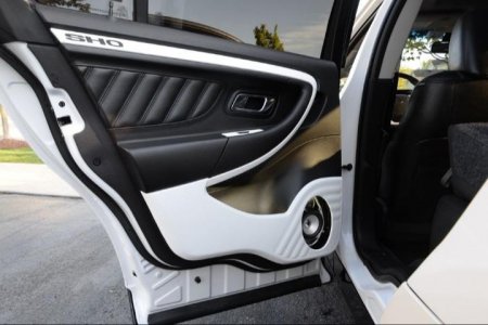

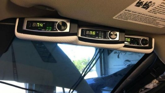

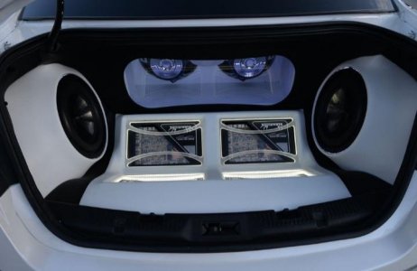

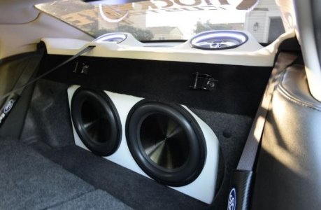

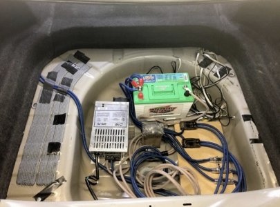

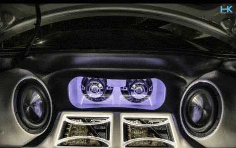

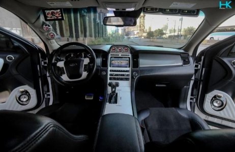

Audio can DEFINITELY be done.
Mine's so flipping loud that it hurts to breathe, and I had to DE-TUNE my amps because I literally vibrated the glue out of the track all around the rear windshield.
2 - 15's
2 - 12's
2 - 6x9's
4 - 5x8's
4 - Tweeters
4 Class D Amps pushing a total of a little over 10 watts of total system power.
Insane build that was done entirely by Mr. Mike Plante when his talents were employed by Shockwave Customs (Mike has since gone independent).
So incredibly thankful for his talents, time, and treasure.

Well, I'm impressed!!!
I was too. Builder is super talented. Blessed to have had his talents applied to my SHO.

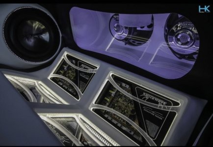

Was trying to find a couple of better pics of the amps (which he affectionately dubbed..... "The Cradle of Power") .... Haha
Also, found an image of what it looks like under all that prettiness as well.
Glad you like.B9b7f6e9e4f72116cc47554bde231408B84c4a829709a02947acfe3abcb9f7ccFdbaaa55526fcb53a641b10ace837ace334c2ca7134880b91be7223dbb5d4b82
