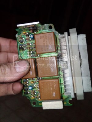

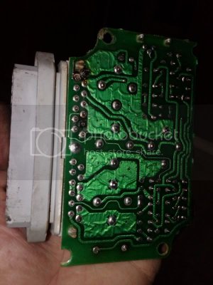

Well what we thought was a simple broken wire has turned into a nightmare. After repairing that wire, I was able to start the car. I ran it for only a few seconds and it started to sputter. I turned it off and immediately noticed the distinct smell of burning electronics.
The CCRM was smoking. It's fried. I grabbed a spare "M" off my shelf thinking the problem was the CCRM from the get go. It's now equally fried.
So this car is a CCRM killer. We checked for a shorted power wire at the fuel pump and fan plugs, but neither one would sound a tone with the ohm meter to ground. I know I still need to check the A/C clutch switch.
I've taken the fried CCRM apart and well here it is...
IMG00115 20100508 1246
IMG00116 20100508 1247
I'm stumped for now. Any insight would be appreciated.

How does the harness look going into the CCRM?
I'd be inclided to think it has something to do with the repair you just did since its never done this before.
how did the broken wire look? broken or fired and melted?
93rev2sev
Nov 1, 2004
6,461
1,825
Hockeytown
Brian,
Thanks for the reply.
The CCRM wires look ok. This problem started after the owner replaced a dead cooling fan and removed/charged/replaced battery. He drove it for about an hour and it died. Sounded like a bad fuel pump but I was unable to pull codes. I tested the fuel pump with 12volts (worked), swapped the b9b1 and "m" CCRM for an x2j and CCRM (matching from same parts car). When that didn't work, I looked for and found a cooked fusable link. Repairing that link got the car started, but smoked the CCRM.
