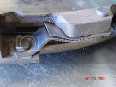

Then the best thing, as recommended, is to grind down the dowels a good bit, then have the insert disc resurfaced. That should make everything good to go. To know if you grinded down the dowels enough so that they're not a problem, is place the pressure plate on the flywheel without the clutch disc...it should sit flush all around the flywheel. :thumb:

When buying a Fidanza Flywheel New OR used its good to have it resurfaced or blanchard (sp?) ground. Then you have to grind down the flywheels a little bit otherwise they will be way too long. When installing a clutch, it should be commen sense to double and triple check this stuff before re-installing the bell-housing and everything else...:shrug:

Even without blanchard grinding the Fidanza the dowels are way too long.
But yes, I think every flywheel (new or used) should be blanchard ground prior to installation if it does not come that way. I never used to dry fit my clutches without the disk, but I do now 100% of the time - even on a stock clutch and flywheel. THere is no reason to take a chance on a known potential issue.

I caught the problem back in May
http://www.shoforum.com/showthread.php?t=61255&highlight=fidanza
and I am sure I am not the first to catch it. I called Fidanza about the problems, but have yet to see any changes. Maybe it is time to call again.

I read that post a couple days before i started the installation of all my new clutch parts. After reading that i made sure that after i got mine blanchard ground, i double checked everything.
This really is a ****** deal and i hope something gets solved from it.
