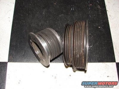

ASP made their crank pulleys/dampers with two pieces, similar to Ford, but they used large O-rings to provide the damping layer, and the O-rings aren't bonded to the pieces, it's just a friction fit. Look closely at the inner hub here, see the O-rings?
Dsc01466
Unfortunately, all the power to drive the engine accessories has to be transmitted through this layer of O-rings, and eventually, they give up, and the outer ring slips with respect to the inner, driven hub. Once it starts to slip, it progressively gets worse until the outer ring starts moving about on the hub, and at that point, the whole mess is a paper weight.
