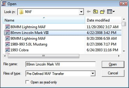

Are you loading it with your own files? If not which EXACT 80mm MAF are you loading?
jmpSHO2nd
Jul 21, 2010
645
147
Massachusetts
I bought the tweecer used from another forum member and it came loaded with a bunch of MAF sensor files and one of them says 80mm lincoln mark 8.

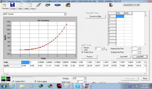

What does the curve look like? The TwEECer comes with all these when you download it from the site.

You're loading the wrong MAF. That looks like it's going up to 1,550 kg/hr? That's Lightning 80mm territory.
That's what your curve should look like.
26748934041 large
Don't blindly richen/lean a curve out. Load the proper factory curve and work with the injectors if needed.

Did someone play with the files? Or did you download it from TwEECer's website?
jmpSHO2nd
Jul 21, 2010
645
147
Massachusetts
I loaded it from the tweecer site a few weeks ago. I am so ****** because for the past few weeks I thought there was something wrong with the car and I replaced a lot of parts in the process and I never once suspected the tweecer.
