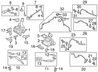

So do I just have to order the turbos or do I have to get other components at the same time?
I had put up the pricing so you know what to expect to pay when the shop does the work, and you can bargain them down if their price is higher.
If you are buying the turbos yourself, then it would be a good idea IMHO to also get and replace the gaskets and oil feed lines at the same time. We have seen enough oil feed line related leaks (technically also a gasket issue) over the years.
AA5Z-9450-C TURBOCHARGER GASKET, RIGHT
AA5Z-9448-A TURBOCHARGER GASKET, LEFT
AA5Z-9T515-F LOWER PIPE, RIGHT
AA5Z-9T515-C LOWER PIPE, LEFT
AA5Z-6N652-A LOWER PIPE GASKET, RIGHT
AA5Z-6N652-A LOWER PIPE GASKET, LEFT
AA5Z-00815-B LOWER PIPE O-RING, RIGHT
AA5Z-00815-B LOWER PIPE O-RING, LEFT
W500012-S437 LOWER PIPE BOLT, LEFT
W500012-S437 LOWER PIPE BOLT, RIGHT
