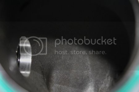

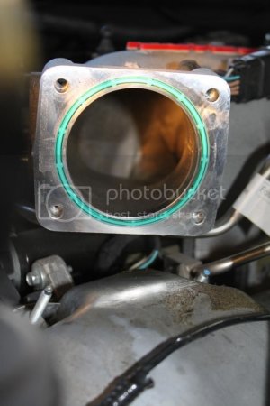

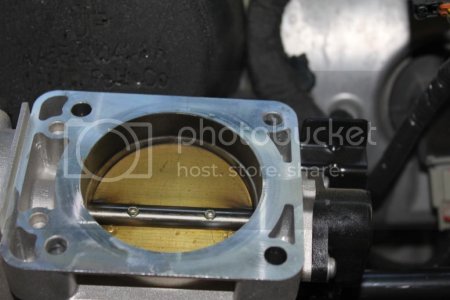

I have had my Throttle Body off twice and there is very little blow by in that area. My intake was very clean both times. A paper towel had very little soot and NO OIL on it. The only dark area was a small triangular soot line at the bottom of the TB. Our EB Engines have a oil catch can built into the rear valve cover that catches oil blow by and then overflows back to the engine, for the very purpose of keeping intake clean. So if you have oil in the rubber hose that attaches to the TB that is NOT NORMAL.
If you need pix, I have some earlier ones of this area. I also have a new scope that I can stick thru MAPv sensor hole in the intake and take pix of that area... Just haven't found the time to use it yet.
Since I occasionally spray water/methanol, my intake does get a bath, but the earliest pix were before spray was installed.

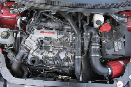

It's on the rear valve cover closer to the passenger end. There are a few rubber hoses that attach to it. You can see it on this pix... the oval black pod that sits on top of the rear valve cover with a drop section that hooks into the cover.
IMG 2279
Here are a few pix of my clean intake manifold & TB.
IMG 2641
IMG 2637
IMG 2634
IMG 2608

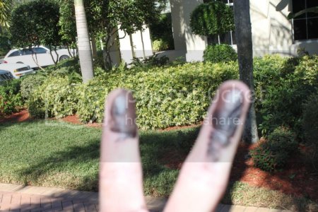

This came off the bottom of the throttle body, and was most of what had built up over about 16,000 mi. My Pontiac G8 was much worse than this at 1/2 the miles. I then installed an aftermarket catch can on it. Accumulates blow by oil at about an ounce every 2,000 miles of driving. Hopes all of this helps.
