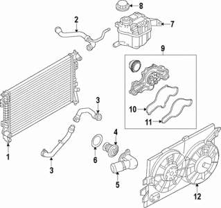

No smoke, but yes the interior smells like antifreeze. Today it overheated again and I was fortunate enough to see where it's coming from. I'll upload a picture if I can, but it's what ever that part is that connects the reservoir feed line to the upper radiator hose. It's a plastic piece so I think it's just old and has a hairline crack that I can't see unless there's pressure on the system. Gonna see if I can figure out a part number and go pick one up.

This is the part

Can't find that component on Fords website. It show's me hoses, but no that union piece. I'm sure if I take it to them they'll be able to figure it out, but it seems like an easy enough part to change myself and avoid the overpriced dealer charge.
TXPony
Aug 19, 2016
38
After digging a little more, it appears the upper radiator hose is all one assembly. Gonna see if anyone has it locally.

I guess we should keep in mind that ANY plastic fittings esp on hoses on the SHO are subject to failure. So far, typically it has been on the turbo-related hoses, now we can add cooling system hoses :D

Yeah, I'm glad it's just a hose as well. Getting it repaired at the moment and doing a full system flush. Hopefully they don't find anything else.
