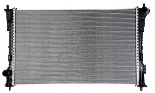

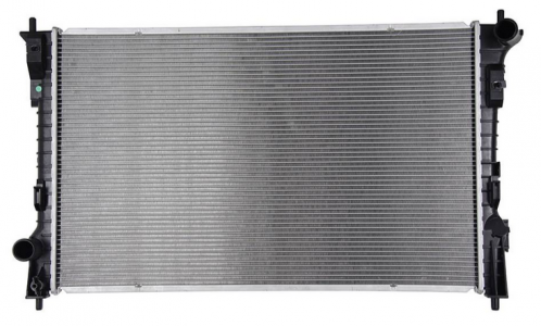

Assuming you are talking about the drain, the difference appears to be between with oil cooler and with out oil cooler.
Without oil cooler
Screenshot 2025 02 20 123358
With oil cooler
Screenshot 2025 02 20 124016
Note that Motorcraft lists 4 different radiators. This is for 2015, other years may be different.

This is what I have - the small inlet or outlet goes to PTU.. bottom of radiator drivers side..- oh yes this is it the bottom one - thanks!
