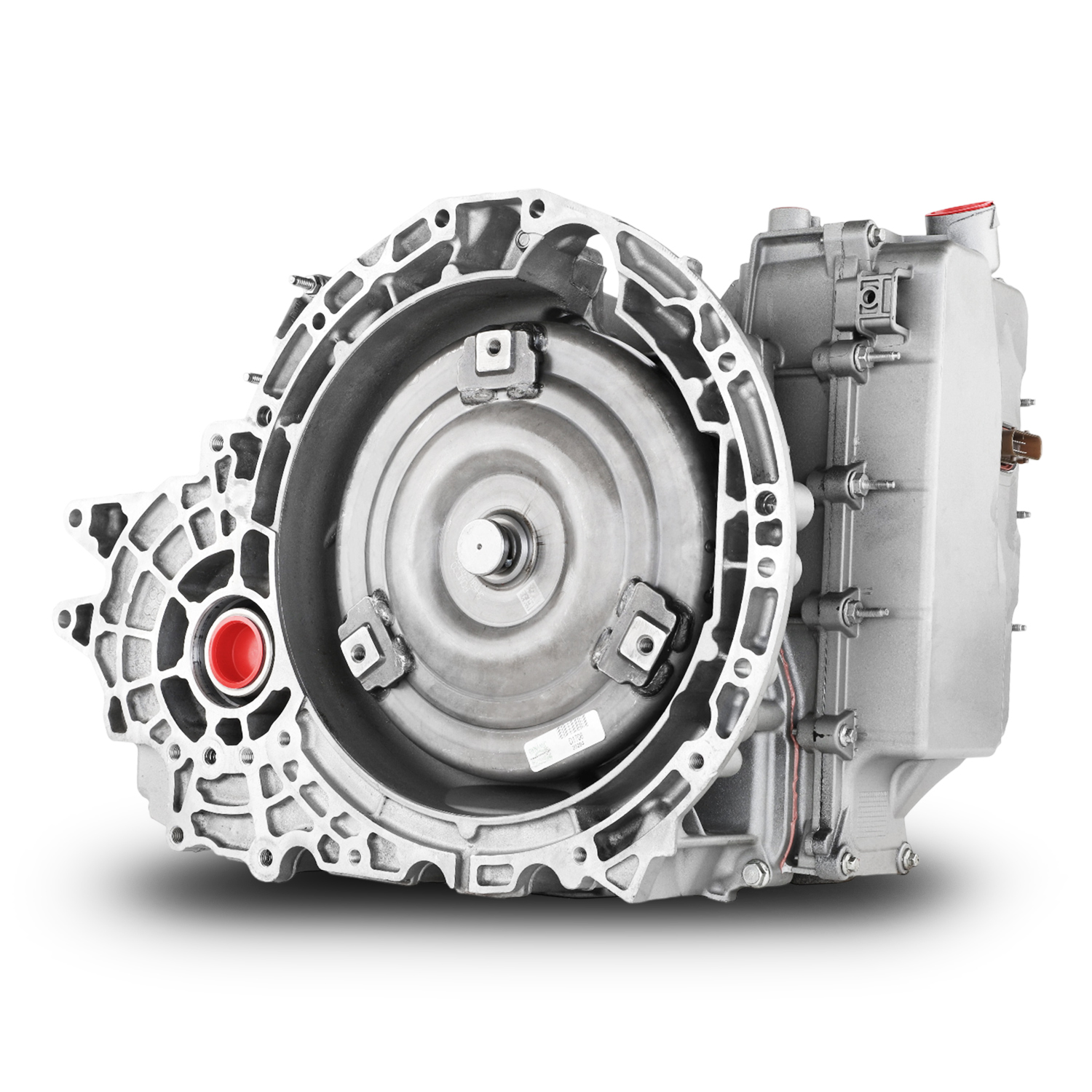

I have oem part numbers
DA5Z-7000-B
DA5Z-7000-L
DA5Z-7000-BRM -- reman oem ford
Ford reman new https://www.tascaparts.com/oem-parts/ford-trans-axle-da5z7000brm?c=az0x
Ebay has roll the dice cheap options like this one???

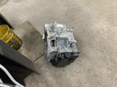

So I need to find the info tag on the transmission to get the right one. I found one on the bottom of the bell housing but the vendor said it's not the right one. Lots of numbers and letters but none that match up. So any of you guys have an idea where it may be ? Girlfriend took it to work today so I'll have to look tomorrow.
13,275
5,153
Send Chad (Irish Pride) or Johnbigdog on the forum a question through the PM, now the conversation function. Top right of the screen envelope. Start typing and screen name should pop up to select. One of them should be able to get you a part number to cross reference. I doubt the xp is SHO but maybe. Are there different transaxles between production years and does it matter for replacement between 10-19? Someone else is doing trans work in some of the other posts in the GenIV section. They also should have part info
