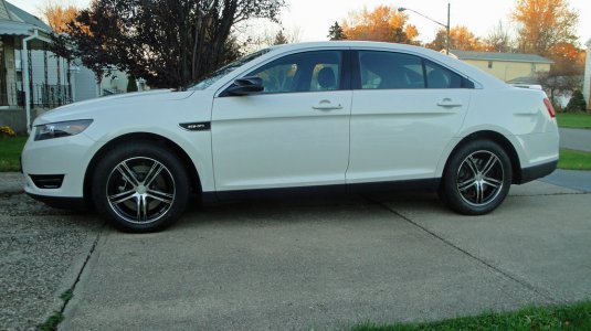

I got the Blizzaks on yesterday, but didn't run the learning program for the TPMS. I figure I'll wait for the light to come on, maybe by some remote chance it'll be OK. I've heard many say that the band sensors will or will not work with a '15 SJB. It took 100 miles for the TPMS light to come on on my '10. I'm also going to swing by the dealer and talk to one of the mechanics and get his take on my situation. Probably should top off the tires with N2 anyways. I'll also ask if the SJB can be programmed to accept band sensors if it comes down to that. I was never really impressed with the way the wheels looked on my '10, it was Tuxedo Black. I love them on my '15 though, Platinum White. I like them better than the stock SHO wheel.
