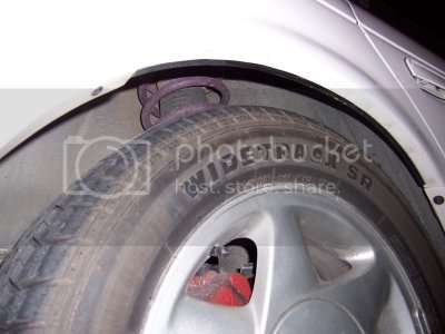

ok i know they are purple so i guess they are intrax
100 1443
how much do those lower the car?
