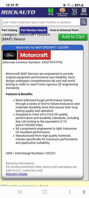

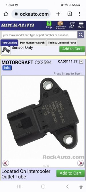

AA5A-9F479-AC is the one on Gearhead tuning website
Yes I know where we use it on the intake manifold. But we use a sensor that is originally intended from the intercooler piping. That one is three bar. We replace the intake manifold map sensor which is two and a half bar with a three bar map.
That part number from the Gearhead website translates to the part number you listed. Screenshot 20230428 121636 PhotosScreenshot 20230428 121904 Chrome
