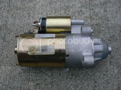

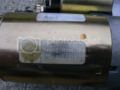

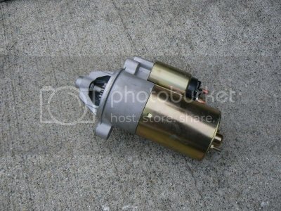

Yep I was right.. its like the teeth aren't big enough.. It was goin out far enough.. maybe this is something I should check... wonder if AZ still has my old one from last night.
Pics of the bling.. lol Maybe gold is the reason.. dosen't fit the color scheme..

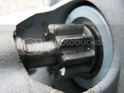

See what 2 seconds of starting did? And yes I have a new (11k miles) flywheel, and it had a new ford ring gear on it too....
P1050462
So now what... is this gear too small? wtf is goin on here... lol

is it me or is there not supposed to be a solenoid ON the starter?
There are several starters for the V6 SHO, Gen 1 starters do not have the Solenoid on the starter, Gen 2 starters do and many early ones have a different size pinion.
