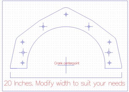

saw the project car today ... ooooh yea !
this is gonna be fun .... and it was nice to see a sho motor, in person, sitting fully inside a RWD cars engine bay
we discussed exhaust routing, accessory relocation, motor mounts .....
and if i can dig my engine out, i should be able to CAD out an adapter plate for alex too .... because its already 1/2 done !

Soo with this adapter you would bolt it to the engine block with counter sunk bolts and it would also have counter sunk studs in the adapter for the new transmission to bolt to? What a great idea! Hopefully this is to bolt a T56 6spd to the SHO engine. If soo count me in for one!
HotRodKid
mmmmm ... turbo
Jul 14, 2006
1,441
642
Western NY
might not even have to be countersunk, depending on where the bolt heads all land
and after i make one, any bellhousing that will bolt to a small block chevy will bolt to a sho motor :)
