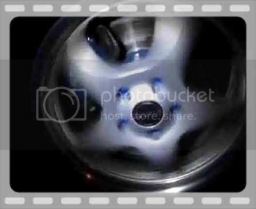

We put the front of the car up on jackstands and run the wheels so I can hear what's making the noise. It sounds like it's coming from the calipers. Could the slotted rotors be making this noise as the slots pass under the pads? They didn't make that noise when installed... but it's possible. I took a video of it, you guys be the judge. I also took a shot from above the wheel to see if it's wobbling at all; the wheel might have been thrown out of balance when it fell off as the hub landed on the inside of the wheel. You can see the freshly painted calipers and brackets that got all fu**ed up :madflame:.

- Just guessing, but I would add a new suspect - CV joint. No guarantees, hard to tell by video sound only. Repeat this test and turn the steering wheel lock to lock. Listen for a difference in pitch or volume. It may announce itself more clearly.
If you get no leads from that, I would take off the wheel and look for indications of contact on the inside of the tire. If nothing shows, remove the caliper and check for something loose or trapped within. If nothing shows, hang the caliper out of the way and repeat the running test. Remember to NOT apply the brakes until the caliper is re-installed.
If nothing found, report back here.

I guess I should've mentioned... it comes from both sides. Equally loud. Also, I don't know if you can tell from the video or not, but the sound is loudest from the caliper area. I moved my whole head around the circumference of the wheel while it was moving and it was loudest by the calipers... but thank you for the tips. I will keep the new hub/bearing for now... and pray to the Parts Cars god should the worst happen. I hope she doesn't lose control if the wheel comes off!

Sound can eminate and transfer thru anything causing it to sound like it comes from all over.
But since there are marks on the brake caliper it wouldn't hurt to one like SASHO91 said remove the tire and see if it stops and then the brake cailper and see if it stops. Keep in mind when you pull rotational mass off the bearing such as the tire the sound may stop as well. So unless you can definatly find something then you may just be just givint the bearing a breather and reducing/eliminating the sound.
The bearing that I just recently replace would not make any noise unless I had the weight of the car on it plus turning a certian direction. Outside of that I only found play/roughness in the bearing once I had removed it from the spindle (Gen III so it just requires 3 bolts to remove).

- Just weighing in again on this. With the caliper hung out of the way, you should try the test with wheel on and with wheel off. When wheel is off, remember to re-install the lug nuts to ensure the rotor stays put.
